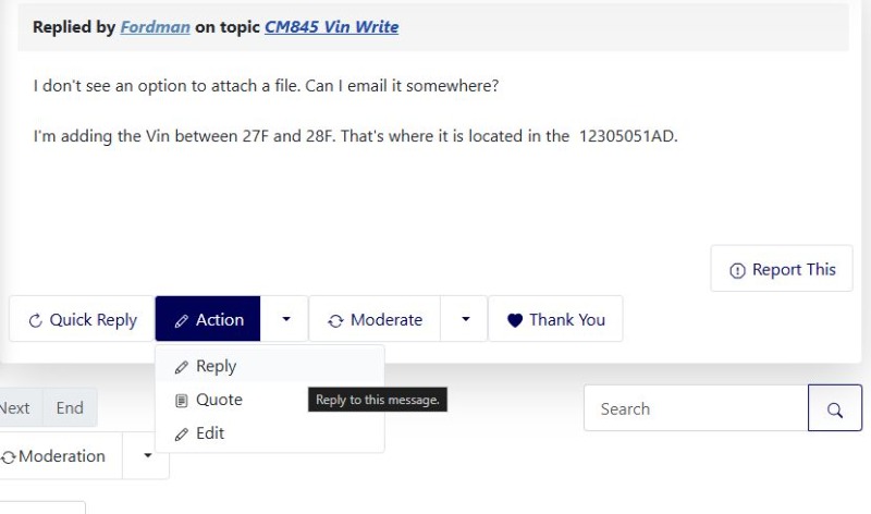

1 year 6 months ago #361 by Fordman
Replied by Fordman on topic CM845 Vin Write
Please login to view the answers
